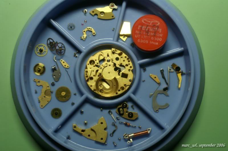

    Internally, the electromechanical Lip R148 (letter J) is clean, but the central contact of the battery is broken (:-S) and the magnetic balance wheel is missing (O|). The "Electronic" stand for the single diode of the system but the system is based on magnetic impluses (a single per altenance) of a balance wheel + hairspring (called "spirorotor" by Lip ...). The impulse are generated by a flexible contact animated by a hair contact touched by a ellipse and a magnetic stator. There 3 different impulse jewels on the balance wheel : 1 for the electrical contact , 1 for the direct escapment, and 1 for an amplitude limiting fork...
    Lip parts can be still sourced and I have ordered one. Unfortunately, there was something wrong in the preparation of the order and I received something that better looks to a balance wheel of the ancestor elctromechanical Lip R27 (1958)...
    Incidentally this morning at the flea market I found another solution: another R148 (letter R) in a cheaper case in poor external condition. A perfect donnor . These calibers were produced by Lip from 1962 to 1976 and are very rugged. They were jeweled with 13 then 11 stones. As quartz step motors the movement is less subjected to internal forces and very easy to maintain.
    Complete dismount of the initial Nautic-Ski Lip R148 caliber and the wrong balance wheel (red box)
    For the second caliber I did not dismount the stator and electrical circuitry because it needs an additionnal setting there after. All the jewels can be washed independentlly of the main plate. Due to the kindness of "Jef06", the complete original Lip instructions for maintenance are available (this link).
    After a careful remount and oiling (take a special care not to distord the electrical contact hairs near the balance wheel), let's try a new bayyery (type "386" or LR43 1.5V). Contact... the balance is moving and it runs!
