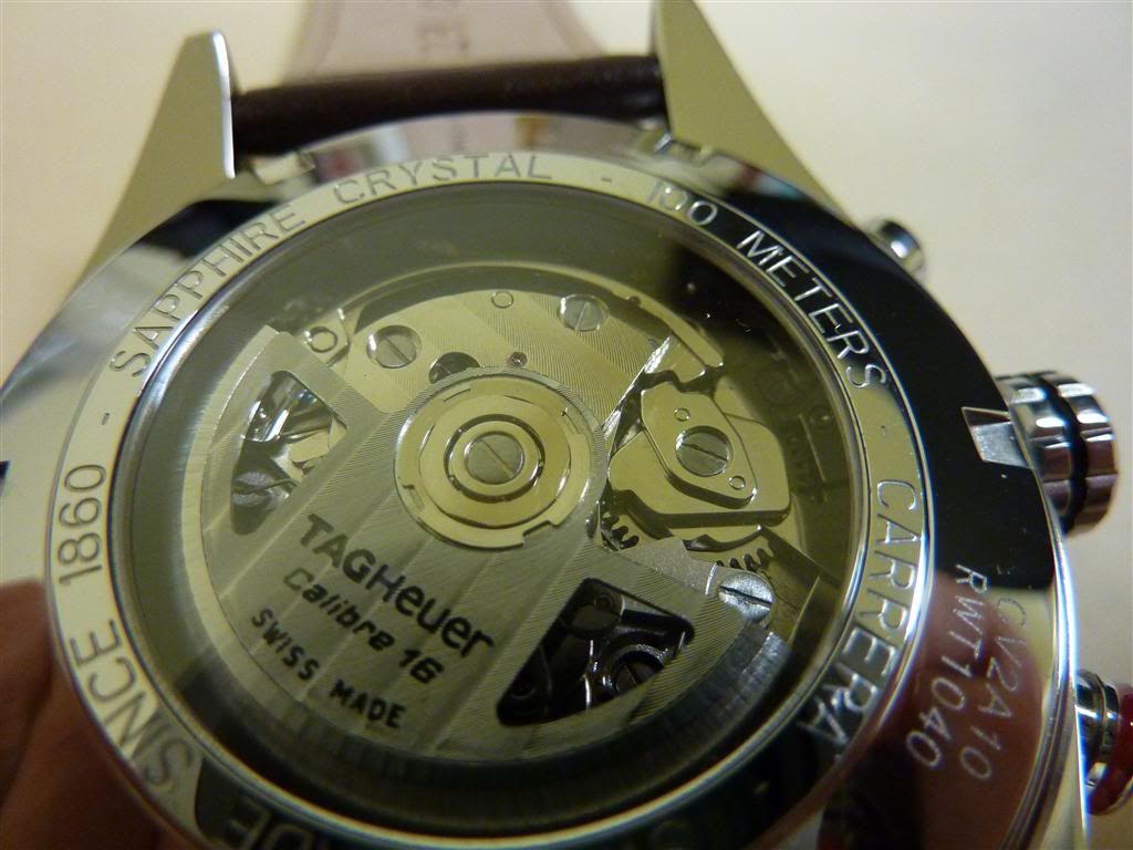

    I just found this sale post at another forum: Tag Heuer CARREREA DAY DATE CV2A10 - White dial - Excellent - Rolex Forums - Rolex Watch Forum. I'm not the seller and I have no affiliation with the seller, but the movement looks identical to me.
    I found two issues in a quick look..the model number on the back says CV2A10..it only comes in black dial and this one is white :)
    Also, the calibre 16 movement is incorrect..notice the incorrect line between SWISS MADE..
    here is a picture of a REAL calibre 16 movement with centered geneve stripe

    Quote Originally Posted by qadhi View Post
    Real sharp eyes Qadhi! Thanks for your help.

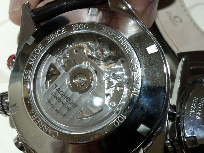

    I also had the answer confirmed by 2 experts face to face - Rob and Russ at Topper Jewelers. Rob sat down with an authentic Caliber 16 Carrera next to mine and pointed out the incorrect areas.
    1. Missing pearlage (something I learned today!) near the hairspring
    2. Bridge near the balance wheel has wrong finish
    3. Screws have wrong finish
    4. Screws have tool marks
    5. Crown action doesn't feel like a 7750 movement
    6. Some of the parts (such as the inside portion of the rotor) are the incorrect size
    Picture of authentic Caliber 16 Carrera
    Picture of fake:
    So unfortunately I have a fake Caliber 16 Carrera on my hand. Thaaanks for the education!
