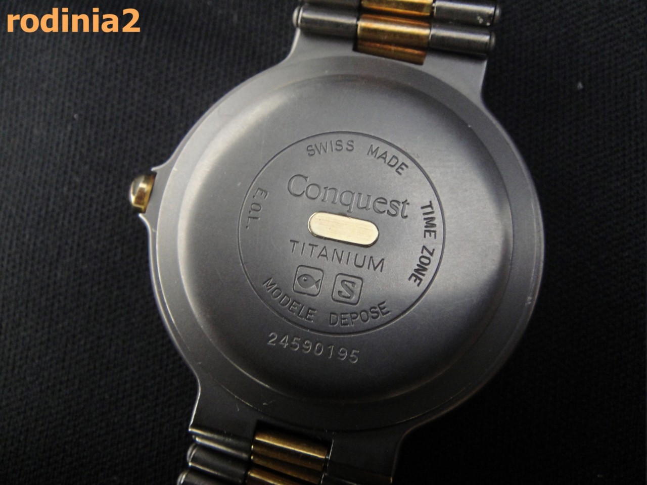

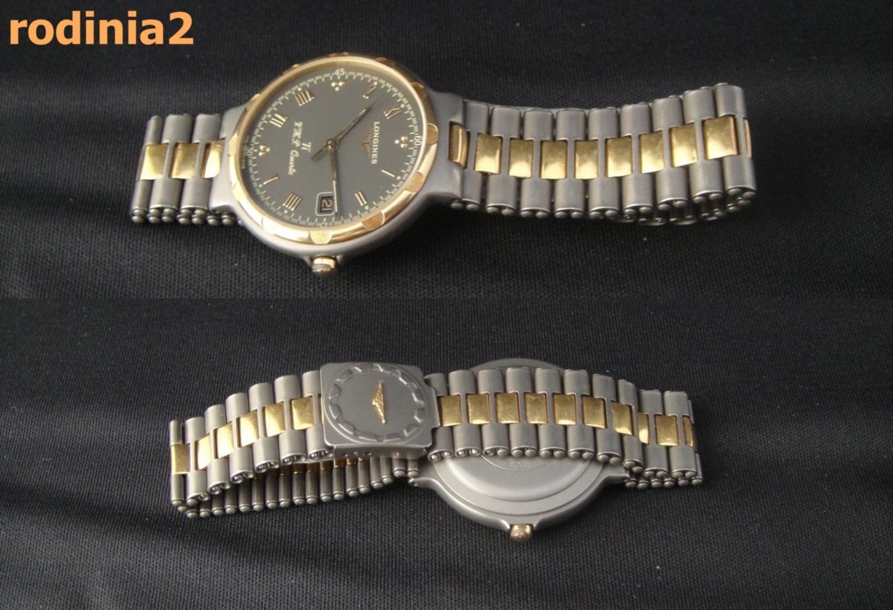

    Well I'm just trying to compile a list, not saying it's definitive. So yours is #3 with a Ti (at least non plated) bezel like on my picture ?
    The back of the Ti one on eBay with the plated bezel looks like this, Ti Back too, I'll add that above :

    @angeche - you got rodinia's ? Let us know when it arrives!
    Nice pictures, doesn't seem to be in a bad shape. Our serial numbers aren't very far apart, 21075xxx for mine and 21800xxx for yours so its a bit unlikely yours would be a later model, maybe they had different versions available...Angeche's is 24590xxx so clearly a bit later. I wonder when they stopped making them...will see if I can find old catalogues online.
