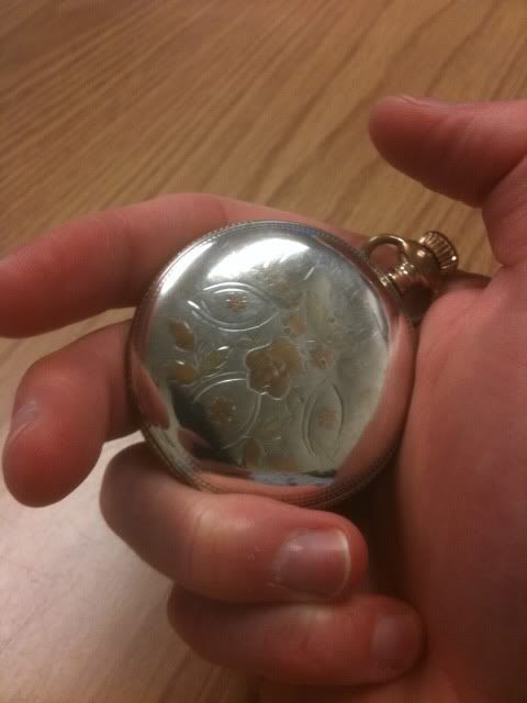

    Family heirloom - My great grandfathers Hampden pocket watch. Circa 1908. The shop fixed the case hinge and gave it a full restoration. Took about 9 months. The wait was well worth it Very pleased with the end result, as the watch was in pretty rough shape. I think he did a great job.
    This thing is more robust than I thought. Also, timekeeping is about + 30 over two days. Thats pretty cool for a movement that is about 100 years old! Its nice to have a pocket watch to accompany my wrist watch lineup. This one is very special
    The watch maker said its circa 1908 by referencing the numbers from the movement.
    Do you know if this watch is "Railroad Grade?" Or was made for railroad purposes, or other purposes? Would you say this is a relatively common watch, or can you see anything unique? Does anyone know about the movement used in Hampdens during the early 1900's? I am also very interested in the case: (Flower, leaf patterns) Watch maker said that it may have some silver, gold or brass plating. Specifically, I am interested to know what the shield on the case indicates. Is this shield a common design / decoration, or specific to some purpose / industry? The nickel and steel inside of the watch is also regulated for temperature change I was told. Pretty cool! Sorry for all the questions - I'm VERY interested in the history of this watch! Thank you!

    A beautiful pocket watch well worthy of being a family heirloom. Your great-grandfather would be proud.
    In the STRICTEST interpretations of the term, this is not a railroad watch.
    A railroad watch had to be open-faced, with the winding-stem at twelve o'clock, so this would fail, it being a hunter-case watch with the usual 3 o'clock arrangement.
    That said, there is no reason why this wouldn't be a good watch. Do you know what size it is or what jewelling and any adjustments it has? You can usually pop open the caseback on watches like this with a blunt knife or a case-knife.

    The shield on the case is called a 'cartouche'. It's a flat, open area on the watch-case that was used for engraving. In days gone by, when you bought a pocket watch with a decorated or otherwise unsmooth case-design, there would usually be a flat space (not always in the shape of a shield) for engraving the owner's monogram or initials. The shield was a pretty common thing, though. I had two Walthams (sold one) which both have that design on them.
