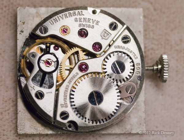

    Cap jewels on the escape wheel have been done in quality movements at various times, but not as consistently as one might think. Here's a tiny Universal Genéve caliber 800 from the mid-60's that has cap jewels on the escape wheel:
    This was in an elegant little two-hand dress watch that was priced at $95 in 1965 or so. (UG was highly respected and distributed by the Stern Agency as the affordable alternative to Patek Philippe.)
    But that is not shock protection, which is not needed for the ultralight escape wheel in the way it is for the heavy balance. It's just a clip to hold the cap jewel.
