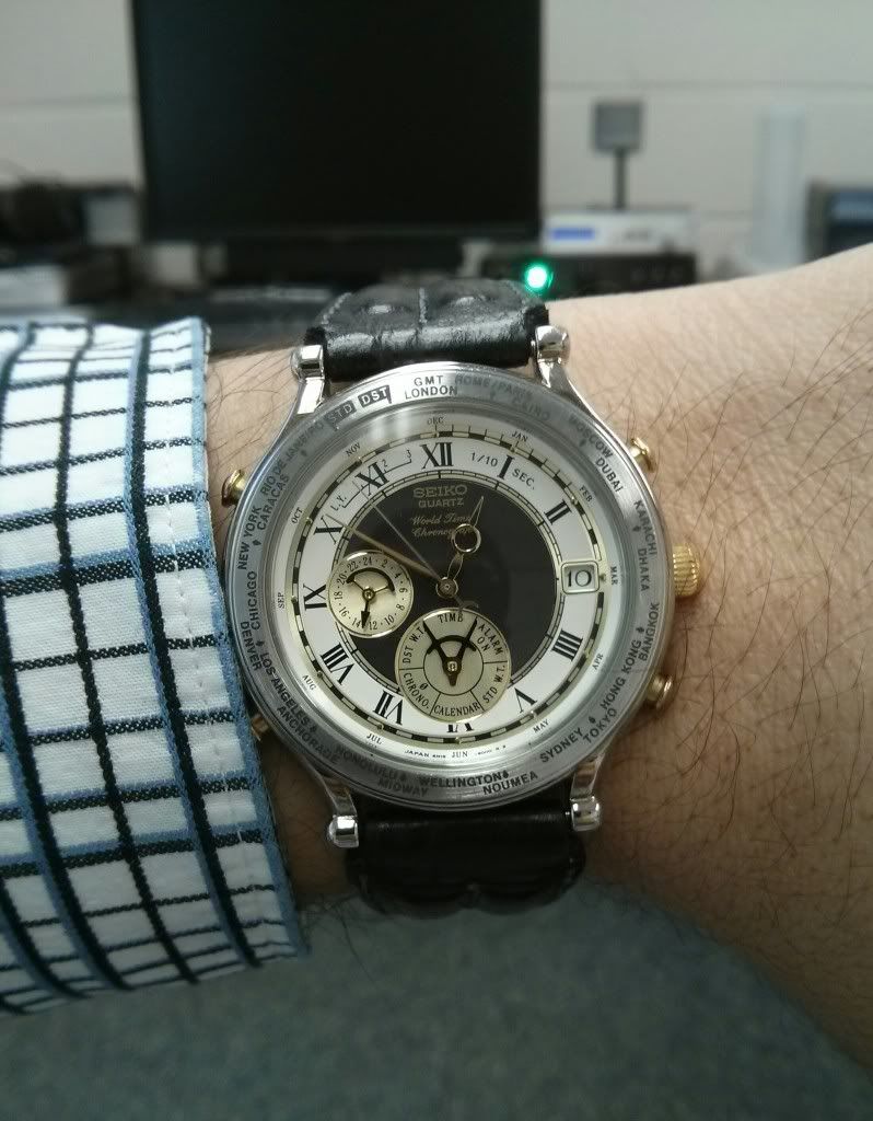

    Seiko 6M15:

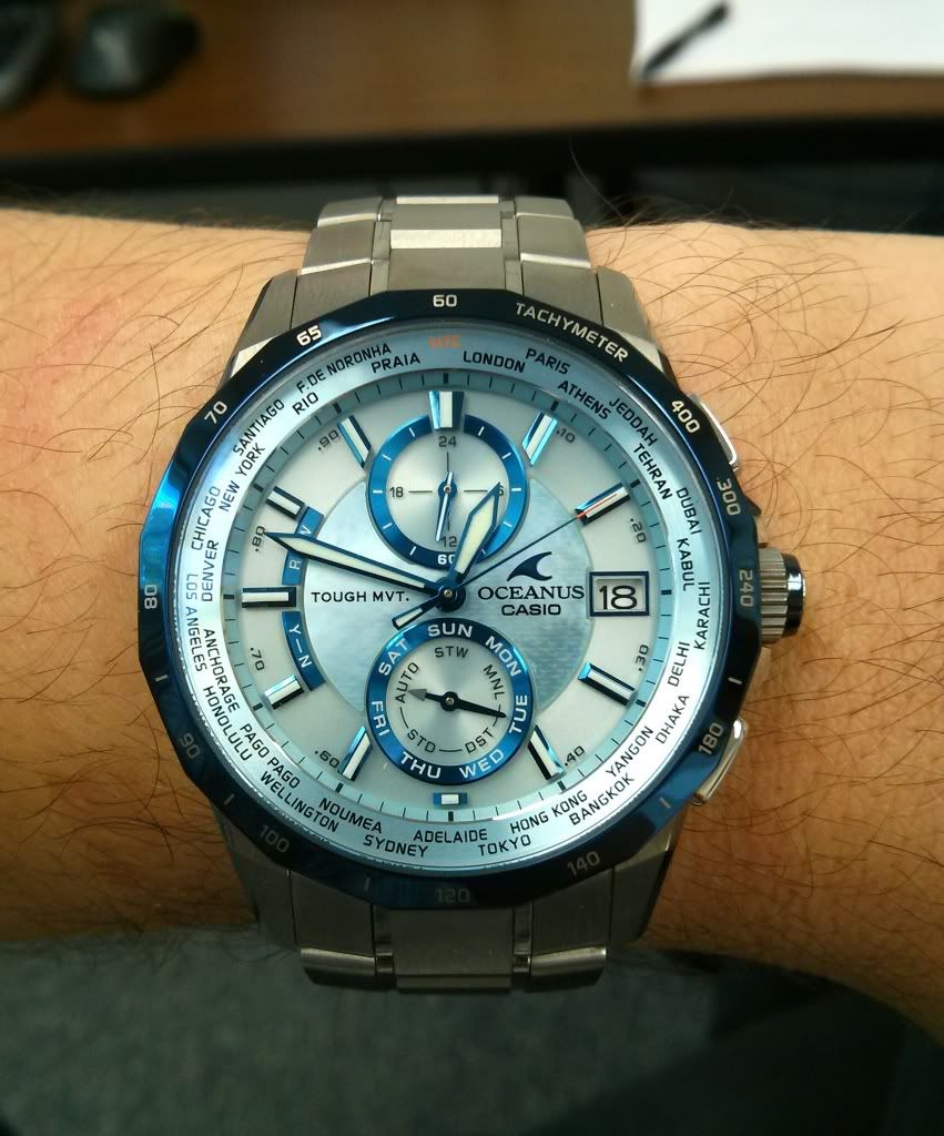

    Oceanus S2000P:

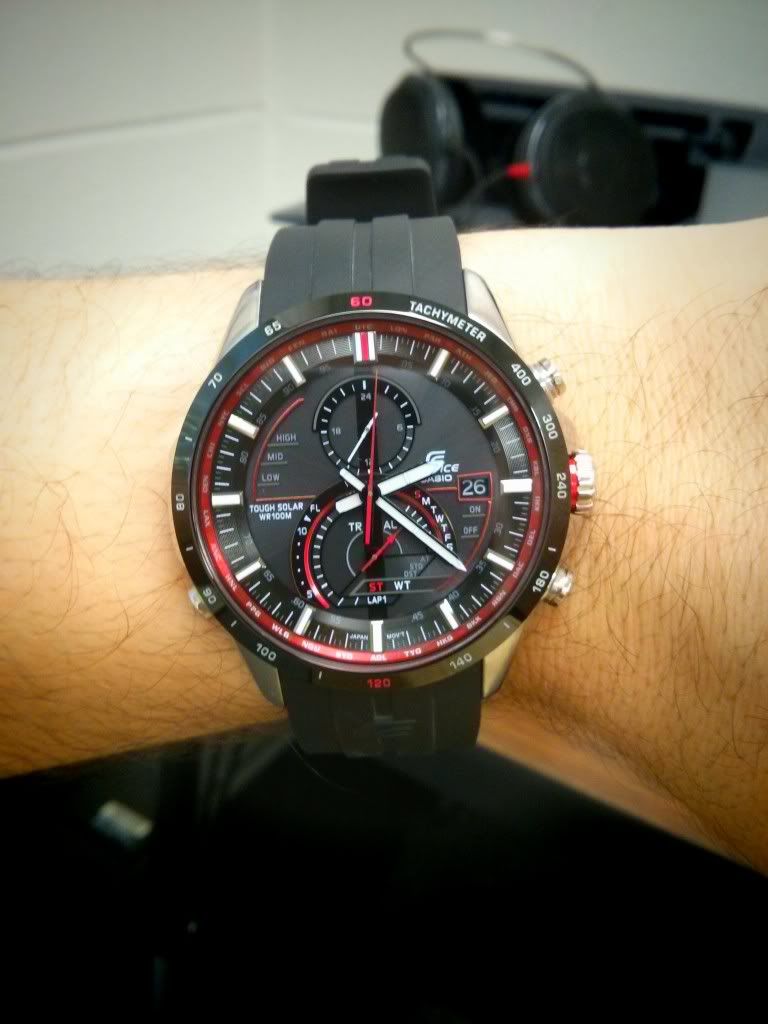

    Casio Edifice 500 something:
    Seiko is done producing these amazing movements. They haven't produced any for almost two decades. Citizen has never produced such watches as far as I know. But fear not. Casio has been doing an amazing job recently. You have two options:
    Get a used Seiko 6M, or a new Casio or Oceanus. I recommend the latter.
    If you wish to go with Seiko, 6M26 is extremely rare. You can find 6M25 (equivalent functionality) but cases are on the small side and not that attractive. 6M15 would be my recommendation; especially the pictured one above from Age of Discovery collection. IT has perpetual calendar, World time, and Alarm as well.
    If you wish to Casio, but prefer a manageable size, then Oceanus is the clear answer. It's about 40mm (specs include the crown), and it's built quality exceeds current crop of luxury Swiss watches such as Omega.
    If you can live with a slightly larger watch in a sportier style, then this Edifice offers an amazing value:
